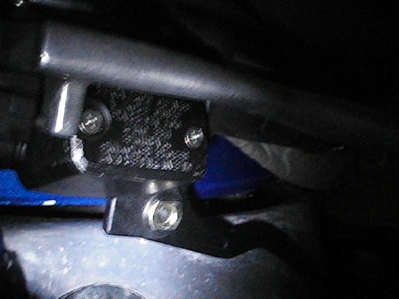

I have a Brembo HB , ive been using w/ a gptech fitting it works great. The only thing is the placement ,no matter were I place it or reposition it I cant set it up so that my clutch lever is close to it. The HB master res. gets in the way I have stock clipons w/ the clutch mounted to the right. If I stretch my fingers just right I can pull in the clutch while pullin in the brake. I want it so I can 1 finger HB / 1 finger clutch it has anyone used this type of brembo HB and had this problem with the placement?

Re: Brembo HB ,placement..
What type of brembo? Post some pics
here is the Brembo HB
oh, that ain't ever going to work.
You need to get something with a remote reservoir
damn it ,I paid like 200 for the Hb ,line and Gptech fitting ,from moto heaven . what & where do I get the right one?
Actually the Brembo Hydrolic Clutch off the ducati works perfect as a HB, OH that one is garbage for a HB NEVER WILL MOUNT!

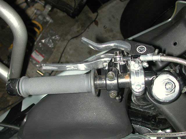

gsx-r 750.. 05.. It's what I use on my f4i and it works sick
I like that setup ,actually I seen that pic on your post a few days ago & it had me trying to reconfigure mine ,well now I know , I should have done some research before just ordering "the kit" ,thnx again man

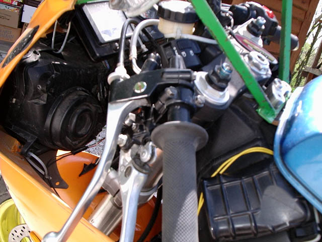

so you saying that a old 900rr master and lever ran upside down better than a aftermarket handbrake master made for left side?
Originally Posted by MikeM
Companies that sell those FOR handbrakes should really knock it off.
At this point in the evolution of handbrakes its common knowledge that those things are only good for taking newbs money.
yea luckily i was broke when i first wanted a handbrake because i figured if its a kit thats meant to work together it must be better that a flipped front master. thankfully those days are over
yes definitely
if you want to use your clutch at the same time it sure is
Damn it! and im not even a newb , a few people had said it would work better. It works great if I reach down for it every time I clutch it up , but I needto 1 finger Hb /clutch , back to the drawing board ,,I might try the vortec cipons . So the brembo 16x18 obviously has a remote resivior ,right?
