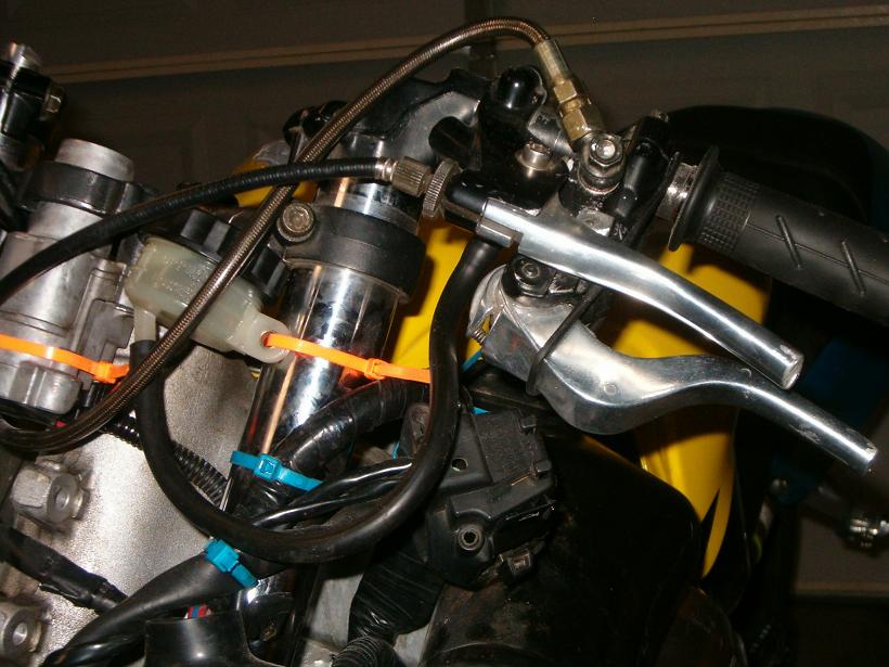

heres my f4 setup

Thanks Ironlung! So it looks like your clip-ons are stock with the switch gear removed to make room. Don't know if I'll fit mine on cos I need to keep the switch gear on. (I ride my stunt bikes to work everyday so need lights n indicators n sh*t haha) I might get some aftermarket clip-ons that are longer though. Also thanks for that link pineaple..some good info in that thread!

cheapest HB out, works GREAT, i can lock my rear with one finger with a normal 03-04 636 front brake master, no need for radial mount or anything!
ask for geoff and tell him i sent you over and he'll hook you up with a good deal on a stunt kit (adapter, line, bajos and washers, everything you need except the master)

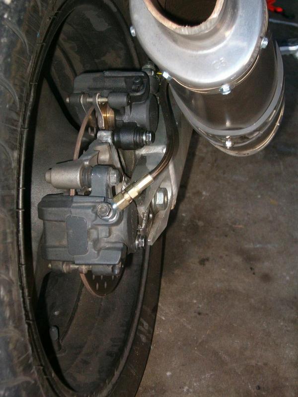

lever and master is a STOCK 03-04 636 unit flipped up-side-down. works PIMP!!! GSXR, R6, actually a lot of front brake masters with remote res., work great too!
here's some pics, not the best but it's all i have right now
Old May 3, 2006 | 12:23 PM
Posts: 85,653
Re: Hand Brakes
John i like that inboard mounted brake

thanks, yeah over here at LEGION we've been doing that for about two years, people are just catching on! LOL if you can grab the end of a FULL lever, you have a great leverage ratio on the master... basically it means you dont have to pull as hard to get the same result with the rear brake! works PIMP and is very easy to modulate the amount of braking force.

i mean using it normal, no need for a "hella" grip, yes, using the end of the lever... where you ALSO have the most feel. one inch from the master is going to be hard and have to feel/feedback.
