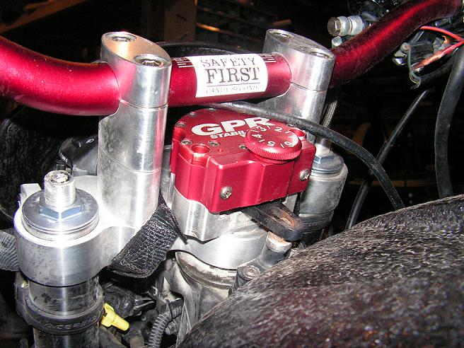

don't do it.....trust me....i had the custom triple made for the GPR.....crazy tall risers, had him make me some new risers and got a hyperpro....SOOOOOO much better now!!!
ID:	165102   Click image for larger version

put the risers farther forward on the triple and the hyperpro shouldn't hit.......mine barely touches at all when the bars are full lock to the right....and doens't touch at all to the left.

those risers are as tall as the ones that were on my bike.............trust me, hyperpro damper and normal risers... mount them as far forward on your triple as possible(so it won't hit the bars on the damper).....you're golden
