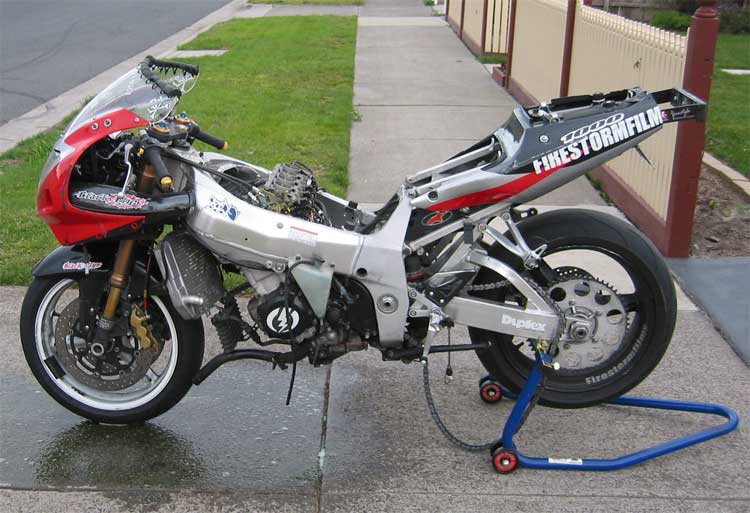

Just wanted to ask about oil pick ups and motor wear. I've got a k2 gix1000 and I blew it's engine this week.
What I wanted to ask is whether any of you know if riding around on the street with your oil pick up done for stunts can kill your motor? Anyone else ride their stunter around for things other then stunts?
The only thing I've changed recently on the bike was the oil pick up and I ride the stunt bike to work everyday (20k's so maybe 13 miles each way). It may not be related but I want to know as I'm throwing another engine in on the weekend and don't want to f*ck it up if that was the cause. The pick-up was back yard made by just looking at the Stuntex pics on their website and making one similar (Bracket with straight tube going down) I did actually try and buy a Stuntex one but it seems those fools don't want business from OZ cos I tried e-mailing them to place an order at least 4 times with no response so said f*ck it! I'll make my own.
Now the major thing that has me puzzled here is that the oil light stopped going off like it used to when the bike was on the bar so I gather the pick up was working well. So if it wasn't good to do to many miles on the bike on 2 wheels, why didn't the oil light go off and warn me?
This is why I'm thinking that it's probably unrelated and it was the motors time to go rather then a shitty made pick up or me riding to long with both hoops to the ground.
Though I'd like to know if I'm wrong.

did you copy to spec? size and diameter?
have you taken a look at the thing you made after it blew? was i damaged?
i have a guy who has 24k miles on his 1k with no problems.

I think it could have been previous wear, since you mentioned the light was on many times in the past.
My oil light never came on on my 01 750, I was revving high on one wheel and bogged down. Figured it was just oil and cleaned out my airbox after it took me an hour to get it started again. Anyway, coming home from NYC one day the thing destroyed itself. Related or not motors blow.
I wouldn't blame it on the pickup, no light means its getting oil BUT the light only comes on when there is NO pressure, you may be running low in pressure..... .02

Yep. It has to be at just the right distance from the bottom of the pan or you will have problems.

Thanks for the responses guys. I didn't think about the point that the pick-up may have not been getting enough oil. I just assumed that the light goes on when there is low pressure, didn't know it meant its not getting ANY oil!!
So maybe running it around with not enough pressure caused it cos either the diamter of the tube was to thin or the pick up was too long/short?
See the pick-up we made we had no specs to go off other thena bloody picture on a website so pulled the original one off, fabricated a steel bracket the same as the original plastic one, then got some steel tubing and welded it to the bracket and made it roughly long enough to be an inch or two away from the bottom off the sump.

Anyhow, if anyone has a gix pick up lying around would you mind measuring the thing for me? I'd really appreciate it cos now I'll be paranoid as F to put that thing on the new engine were about to put into my bike this weekend. Can't afford another one after this!!

Bump bump bump....so anyone have any info that can help? Cmon there's must be a whole heap of cats on this site that ride gixxers with extended oil pick ups.
Look at the pic...I don't want to be doing this again anytime soon

Did you buy a proper one or a backyard one off ebay or something?

Not Sure How I Missed This Thread, But Can Always Be Reached Here. There Alot Of Missing Factors Here, How Your Pickup Was Setup? Exactly What Failed In The Motor? Condition Of The Rest Of The Motor? Etc.
