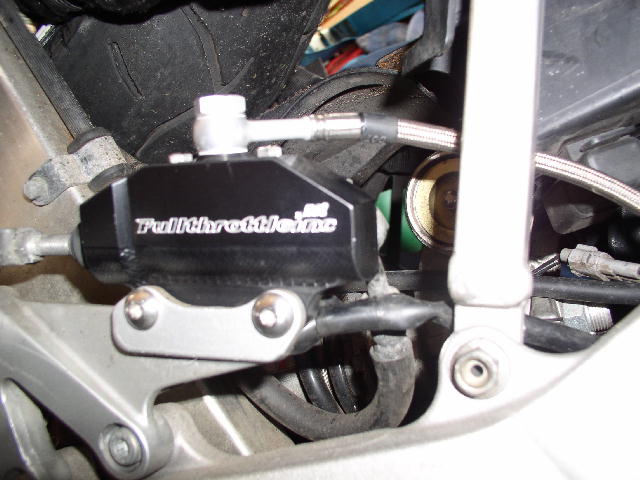

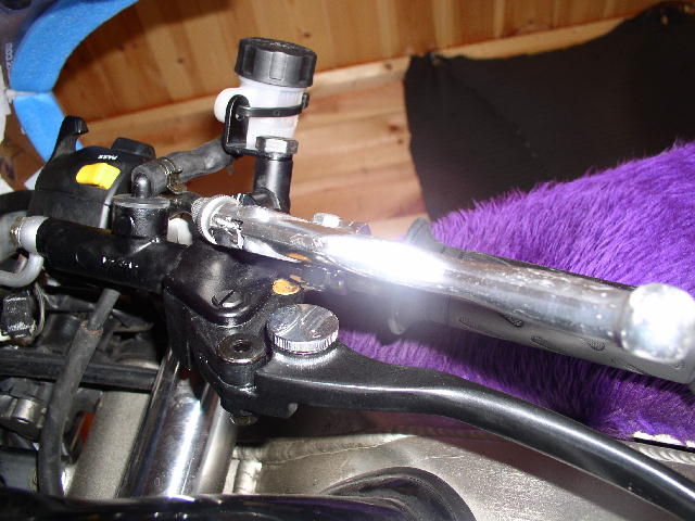

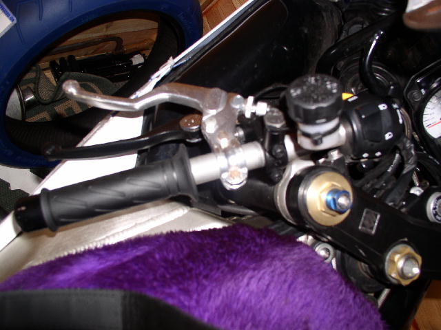

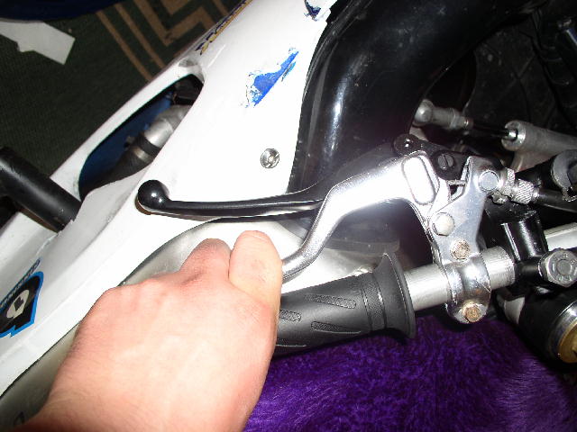

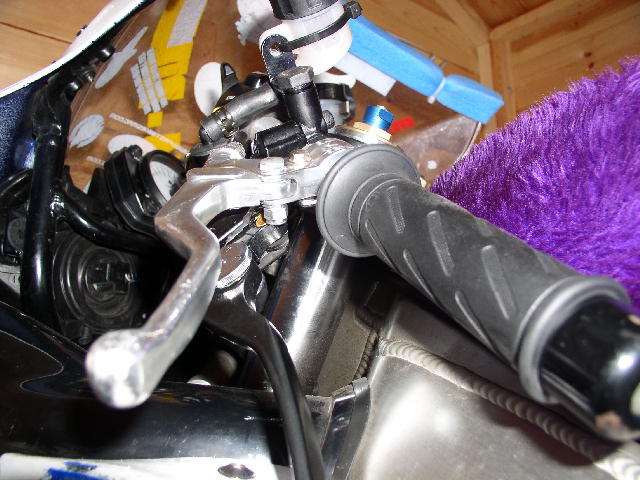

the pic's you asked for mate, its the old bike as i aint got pic's of the new one yet. let me know if you need anythin else

what bike is that clutch unit off Lee? it's got a nice narrow clamp on it, ideal for cramming onto my crowded bar.
Does that smart looking junction cyl work well? I've got a welded up frankenstein version made from two old Honda bits, it loses pressure on the bar brake when you've been using the foot brake. It works great 2nd squeeze, just not there when you need it first go. And, If I squeeze the bar brake it pushes the footbrake lever upward - does yours do that? If it doesn't then I need to get a better setup.

clutch is off a DT125 and worked well, need a new one for the new bike. it works wicked, lock the back wheel up when pullin away if you wonted and yes, pull the leaver and the foot break comes up, cant use both at the same time
