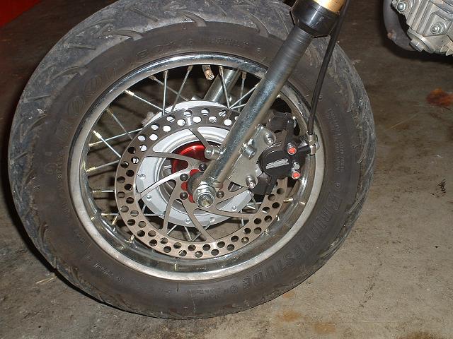

five0 disk brake kit
just wanted all to know how pimp the +1 kit with a hydraulic disk brake set up is $300 from http://www.fiveoracing.com/
easy to install and stops on a dime

Re: five0 disk brake kit
it comes with the rotor,hub adapter,caliper and pads, brake lever, cable, and +1 legs
there is another one though that includes all of the above plus the derlin no slop bushings
Sano makes this kit it is $ 309
but I already had the bushings so I opted for the five0 kit
well I can attest to the master cylinder taking some abuse flipped a few myself. and yeah the kit works great, lever is nice and fits hand well, the only thing is make sure that you break in the pads. I was an idiot and romped on the brakes as soon as I put the kit on so I had to pull the pads out and sand off the glazing
other than that good ****
no the forks themselves do not take the slop out but they are much stronger than the stock legs and the flex is a fifth as bad when you smash the brakes. what takes the slop out of the forks is the derlin no slop bushings or copper bushings.the best place to find these is www.50ccracing.com the stock plastic bushings suck. this kit makes your forks feel five times better. I am very happy with the kit and think it is well worth the $300
wait til u take it apart and look at the stock fork legs and bushings... the +1 fork legs and aftermarket bushings are night and day
