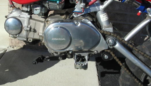

Old Sep 26, 2004 | 08:45 PM
Posts: 1,216
From: Woodridge, IL
900 Fury is an unknown quantity at this point
Re: polishing
here we go
