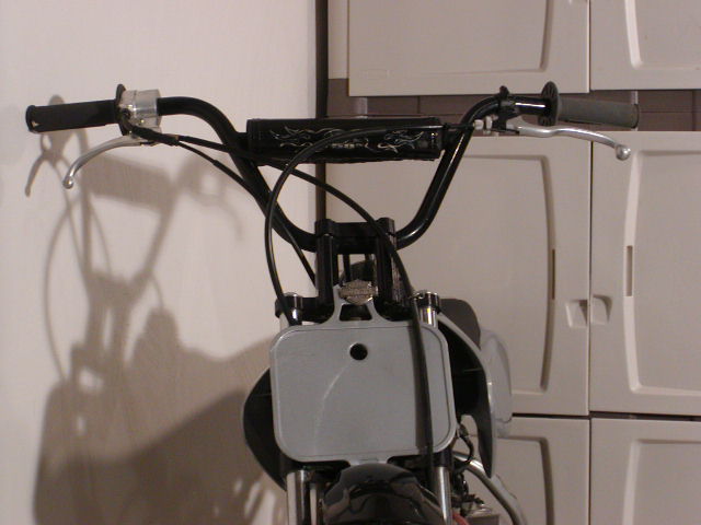

Well it doesn't go to the left side of the bike now it goes straight from the throttle to the right hand side of the tank (under) and to the carb. I think were on the same page there. I think maybe the bars are just a bit too tall for the stock cable. I don't have any pics that show it here at work I will post one tonight. I still just think I need a little more length to the cable.

Re: Longer throttle cable
I think I got some talls bars mine has a 2 1/2 inch riser then bmx bars and I still use the stock cable no probs here

hmmm then I must be doing something wrong then. :| looks like the same way I have mine routed too. not too sure.. nice bike too btw..

Well I got a couple pics but I forgot to look at the adjuster I will do that tonight. at any rate here is how my cable is routed:
Man, ur cable looks like its smaller then usual. Instead of the cable running right underneith the tank & frame. Mine, just sits on the right hand side. it might be that your frame and tank are pinching ur cable.
Yea its a pretty snug fit.. That's why I was wondering if the 2 inch longer cables was gonna be enough extra slack or if I need more?? I'm thinking that A: I got like the last cable on the run they made that day and it was a bit short, and B: the longer cables that everyone sells that are two inches longer then stock aren't going to be enough cus that would basicly make it the length my stock was supposed to be. So I am thinking a 4 inch longer cable is what I need to get it all proper but I dunno where I can find one. Every where I go I only see 2" longer cables. :|
Just realized what I said im not adding it to my existing cable it will replace it so that was pretty dumb. The 2 inch longer cable would be 2 inches longer then what a proper length stock cable should be so that should be enough cable.
However it does seem my cable is shorter then normal?? Atleast I am correct on that end of it..
