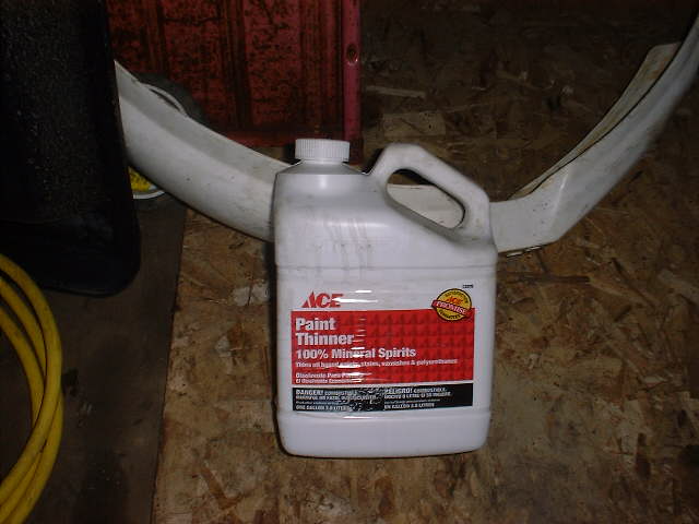

serslyfkdup's Avatar
Posts: 141
From: ohio
serslyfkdup is an unknown quantity at this point
Re: K&N Filter - Best way to clean?
this stuff I am positive is the same stuff as k-n filter cleaner
Old Apr 16, 2004 | 09:31 PM
fab5fiddy's Avatar
Posts: 2,287
From: Cleveland,OH
fab5fiddy is a decent person
smells just like brake cleaner. get yer cheap *** to walmart and buy a can for $3. then oil it with somethin.
