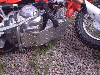

Whats the deal peoples, new 50 owner here..
I'm trying to fabricate a skid plate tomorrow. I saw that fab5 guy had made a super hot one for his, and I just had a few questions..
I see where the back of the skid plate bolts on, how about the front?
Has anyone else made one?
Is there anything I should look out for when building it?
Any plans for this thing out there, or is it just an eye it up kinda job?
Where can I get the diamond plate?
I work construction so I have all the tools at my disposal. Thanks for helping a niccah out.

Re: D.I.Y. skid plate?
make it out of poster board first bro. get the diamond plate at a metal recycling place or something like that. it aint hard. just take your time and it will come out sweet.

this is all i have...

so its only bolted on the bottom two bolts?
yes and the 2 bolts on the cylinder

Word.. So the two bottom bolts, and the 2 on the front/top on the cylinder.
Did you bend the diamond plate or weld seperate pieces together? I'm guessing you bent them.

i welded the side ones, but u can use rivets, bolts or whatever if u dont have access to a welder. use your imagination. no problem wit the IM. i wouldnt put it on here if i didnt want to help anyone. work has been taking up most my time but if my away message is off, im here.
