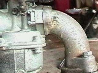

Re: 16mm or 18mm or 20mm
go to the motorcycle junk yard
and get a stk xl 70 intake
plenty of clearance
Name:	xl 70 intake.JPG
