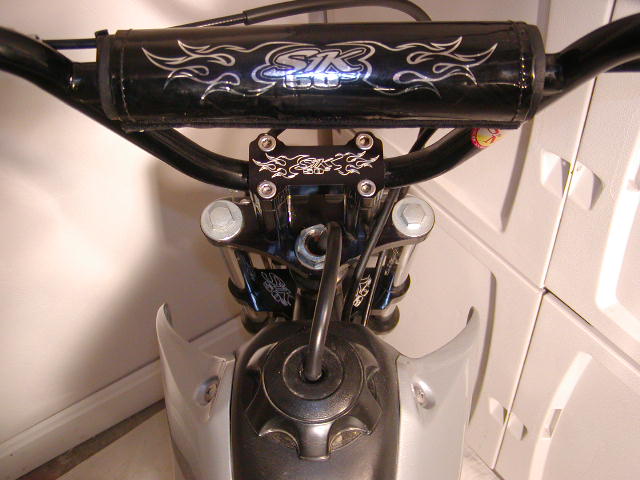

I went for the sic 50's set up I love it
ID:	61834   Click image for larger version

Weedracer...what forks do u have on ur bike? Xr70?
