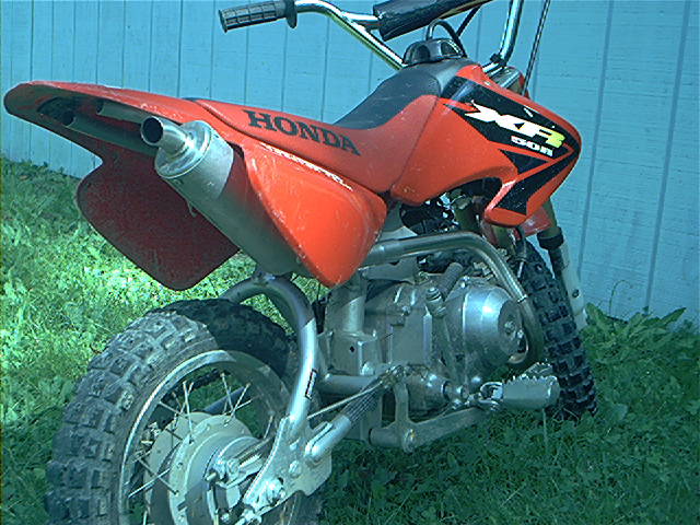

prolly wont help ya too much cuz i made mine, but here is a pic. any aftermarket exhaust with a somewhat small primary would work nice on a stock motor. and the filter will compliment it nicely.
