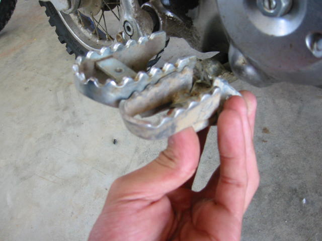

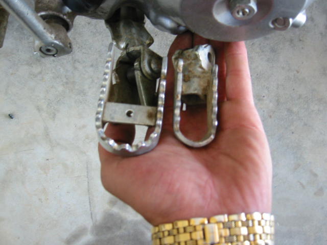

Here are some pics of 150 pegs against standerd pegs..

thanks kiwi those pics are perfect.

Thanks for posting a pic of the 150 pegs. I ordered a pair on blind fair these guys were giving good advice. I'm gonna be happy with those

Cool, only mod you need is to slightly bend standard peg return sprin a little to make it fit 150 pegs. All the other standerd hardware slips strait on.

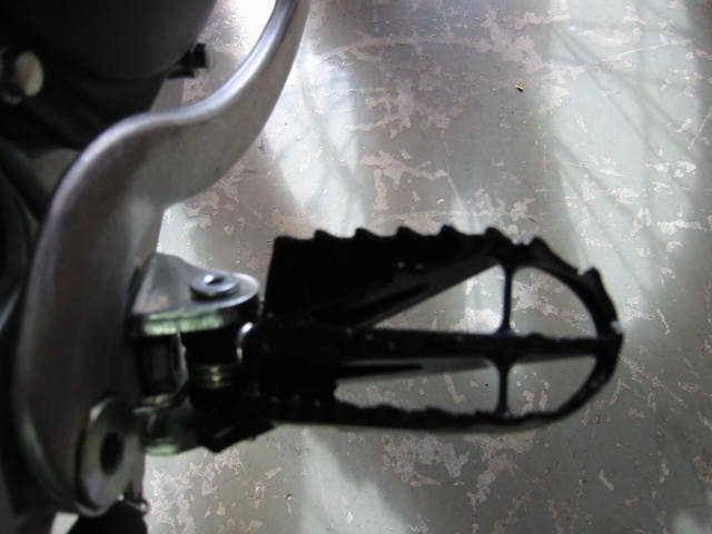

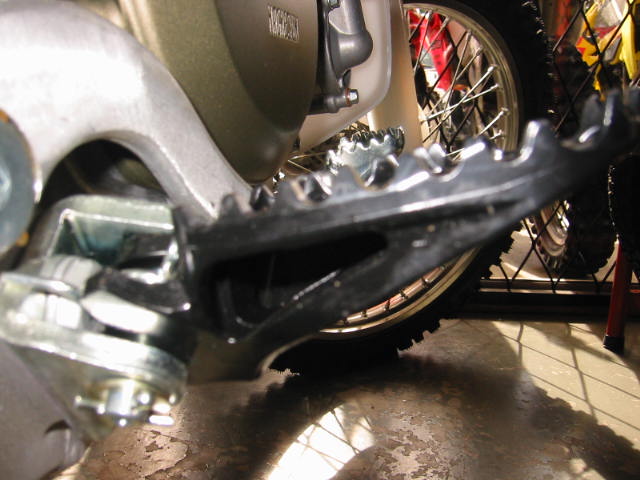

Pics 250 pegs, they look quite good but they should for twice the price.
they look like they will fit strait up, they are about $215NZD, about $105USD over here. IMHO spending that on oem pegs is a waste, when you can buy billet aftermarket for the same money as these 250 pegs.
Dealer told me a few guys have broken these pegs on there 250s, & because 150 pegs are half the price & stronger they have replaced with 150 pegs..(Thats what the parts guy told me anyway)??
