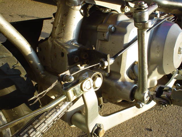

i built mine at home, you'll need a bandsaw, a drill, a tap set and a few screws adn bicycle clamps
you'll weld 2 flat rectangles together, in an "L" shape, tehn brace it by welding a triangle to each piece rith in the 90 degree joint to brace it, then drill holes through it to your frame , tap them to M6 x 1.25 adn get some metric bolts and mount it up,
then i welded a flat piece with a bicycle cable clamp to the brake arm... it's pretty simple if you look at it

Here ya go it works and I did it the first day I got my fiddy
