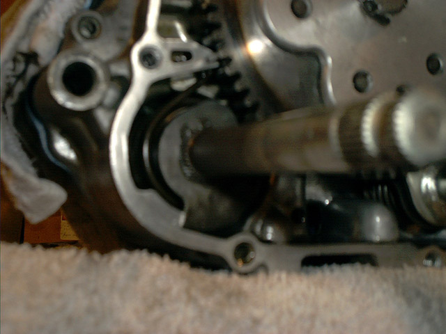

fab5fiddy's Avatar
Posts: 2,287
From: Cleveland,OH
fab5fiddy is a decent person
Re: Kickstart help
heres a different pic of what it should look like assembled. let me know if u need any parts. i have spares everywhere. PM on the big bore..
