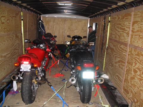

As far as chalks go, I feel that they are a waste of a lot of money. I have about $250 worth of them, and they bent about $450 worth of rotors on my bike. If you use a canyon dancer up front and two straps off the rear pegs, all of them going outward at angles not parallel or perpendicular to the bike, you don’t need chalks. The front straps hold to the front and the rear straps old to the rear, like this.
ya, you have to hook them wide to stabilize them. i've never bent a rotor and i'm pretty mean on mine. you must need wider wheel chalks then.
I didn’t have any problem with stability, and we went form Lafayette, In to Alcoa, Tn, and back. But, your right the problem with the chocks is that they aren’t wide enough, but I have yet to find any that give more than about a 1/16 inch clearance on each side, not much room for error when loading it and I did spread the ones I have a little, as much as I could without actually springing them, it helps to hold them in place, they are the removable ones. But with 4 straps you don’t really need the chocks anyways.
on good bikes i would. just bend them out manually. but ya, even with 4 tie downs i've had the bike wobble enough to loosen and then the front tire skid and down it goes. just a stunt bike so no biggy.
They can loosen up, but I just check at each gas stop, and never once had to tighten the straps. I didn’t have any problems, not even with Mike (cow bike) driving. But, I don’t know if you can tell from my pictures, I’m not exactly a small guy , and I do put a little a$$ in to tightening the straps, and I have the good straps, not the dollar store models, and so far I haven’t had any loosen up yet. Besides, what is the difference between a good bike and a stunt bike anyways? They are all meant to be ridden, and if it goes over it gets scratched, oh well, it is usually still rideable. Just ask Mike, or any of the Lafayette guys about how meticulous I am about cleaning my bike, and not scratching it.
