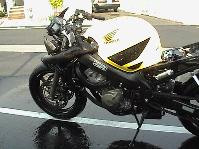

I CRASHED MY F4I AND I TURNED THE POWER OFF ON THE BIKE ---ONCE I GOT MY FRIENDS TRUCK AND GOT IT HOME THE POWER WILL NOT COME ON ---I CHECKED ALL THE FUSES AND THE BATTERY IS FINE -----ANYBODY GOT ANY SUGGESTIONS???

The ignition switch or check that the ground lead from the battery is still grounded.

check to see if your starter solenoid is working.. you can do this by grouding it and listening for the "click".. also.. try push starting the bike.. if it starts up and runs fine.. make sure all your grounds and leads are good going to and from your starting system switches and starter motor and relay..
best way to do this is get a multimeter and set it to "resistance" / "ohms".. you should get 1-5 Ohms of resistance if the connection is good..

THANK YOU GUYS ---I GOT IT STARTED TODAY --I TOOK THE TANK OFF AND FALLOWED ALL THE WIRES ---IT TURNS OUT THAT GROUND WHIRE THAT CONNECTS TO THE FRAME WAS PINCHED AND NOT ON ALL THE WAY-- STARTS AND REVS LIKE A CHAMP NOW---ALL I NEED NOW IS A PEG AND IM GOOD FOR SOME WHEELIES AROUND THE BLOCK----THANX AGAIN
