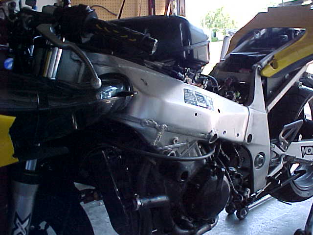

Do just like bunarocket says.. I have done the same thing and thats exactly what I did when I did mine... Here are some pics to help illustrate the differences...
The first two pics show what the stock 600 frame looks like with a 750 motor bolted in. As you can see the front motor mounts are barely off. Once you get the 750 bolted in using the back engine mounts, take it to the shop, have em cut the mounts off, shave em and weld them back on.

heres the right side.

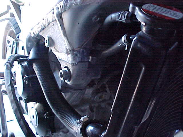

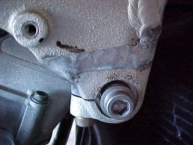

here are the after pics...
left side
Old Oct 23, 2003 | 11:10 PM
Lb3's Avatar
Lb3
Posts: 5,133
From: Dallas, Tx
left at another angle

oops...
