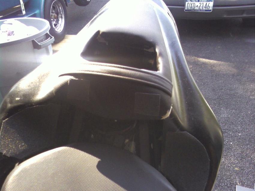

anyone have a hole in the seat of an 07/08 ? or any other bike with a tiny *** seat like those ? lets see some pics. i wanna do one but dont know if the hole can even be big enough to be worth it.

what size shoe do you wear?
you can do it but there isn't much room and the hole is going to be on the smaller side of things.. i can take a picture for you tonight if you need be.

10.5 . skateboard shoes so they are wider. any special tips on how you did it ?

it was acually my buddy that did his. he's got the same bike. it gets really thin on the sides, he wears the same size i think. i'll double check with him how he did it, but i'm pretty sure he reinforced the outline of the hole with some crap aluminum or something. to cut the hole he just marked it out and dremeled the plastic underneath. then took a razor blade to the foam. pushed the cover in and stapled it on the inside. i posted a picture somewhere on here or stuntride a while back. but the picture isn't on this computer here at work anymore... hope that helps, i'll take a couple pics tonight when i get home too so you can see the hole.

hole in the seat works good, there a metal plate in the rear seat cut infront of that, i've had the same rear seat since i bought it and cut a hole in it the day i bought it, doesnt' matter how big your foot is, cut a hole. if its to small... make it bigger...

don't worry about re-inforcing it with anything unless you want to, there is no need for it.. i wear an 11 wide *** skater shoe and its perfect

he just re-inforced the sides where the plastic was thin. cause when you put your foot in it the plastic part underneath bowed out and broke... heck he might have even just taped it back together...

thanks for the help guys, that picture looks clean. ill probly try and do the same spot !!!

hole in seat is done. came out pretty good. just to the other side of the strap there wasnt a ton of fabric to pull down and staple very good. but i got it on there. should be good enough.
i put some grib tape around the fender and two tiny ones on the seat too! i was riding in the rain yesterday workin on circles and couldnt stay on the bike lol
