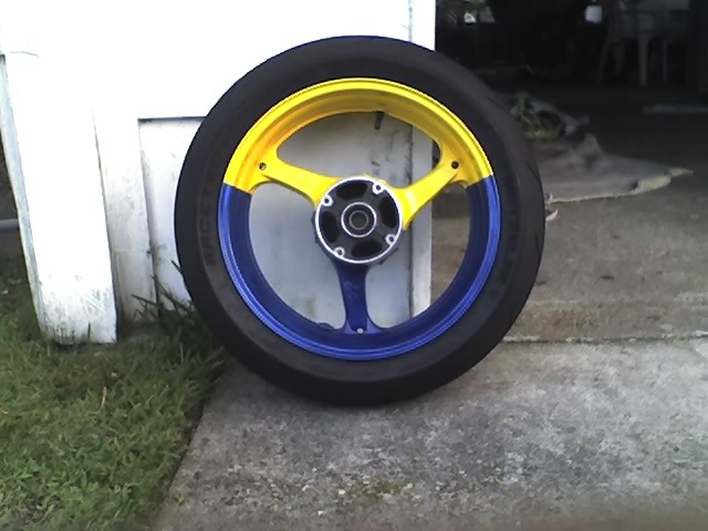

I'm thinking about stripping my f4i down and hitting the frame/wheels/swinger/forks/engine with duplicolor metal cast..
Question is, what should I prep the metal with for the metal cast? DO I need to use duplicolors base coat? Or is white or even silver paint fine?
Wanting to stay cheap, would rather get some cheap white or cheap silver paint instead of buying the duplicolor base coat..

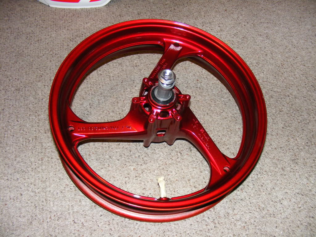

i had my rim sand blasted then i hit it with a light coat of dark grey primer,then metal cast ground coat followed by the red...and wam........Name:  DSCF3902.jpg

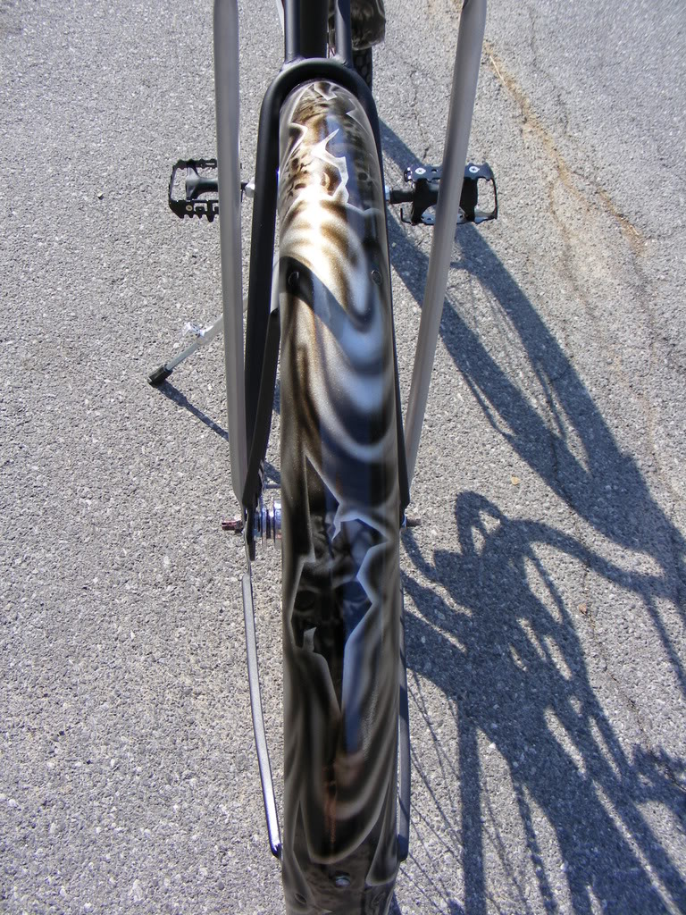

heres my old paint job.. Name:  DSCN3467.jpg

I'm just really broke right now, haven't worked in 3 months since I broke my foot, and 2 weeks BEFORE I broke my foot I put my bike down at 55 with no cage so my plastics are FUCKED
I was trying to do a under $100 paintjob including EVERYTHING.. Was gonna try to bomb my frame with silver or white and hit it with the metal cast, then just bomb my plastics with $1 a can white
btw heres my last 2 paint jobs, both used $1 a can white from walmart, and $1 a can clearcoat! But the green was 'grabber green' $5.99 engine enamel, and the blue was some $6 **** also (forgot the brand)

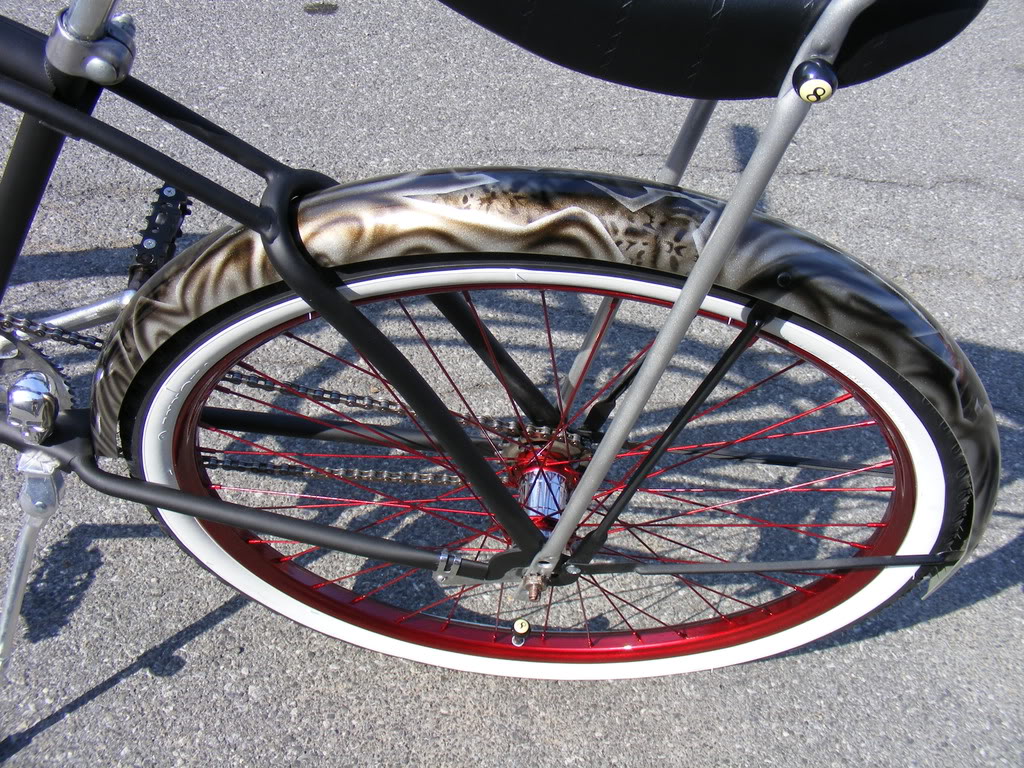

heres what i did with the base coat and the duplicolor high performance clear wheel coating....and some airbrushing in black....
Size:  298.7 KBName:  DSCF5278.jpg

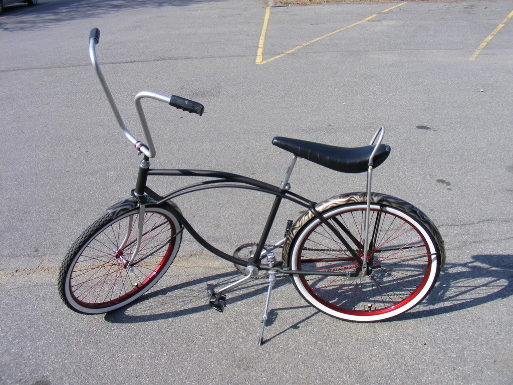

custom bike i did for my bro...
all rattle can...

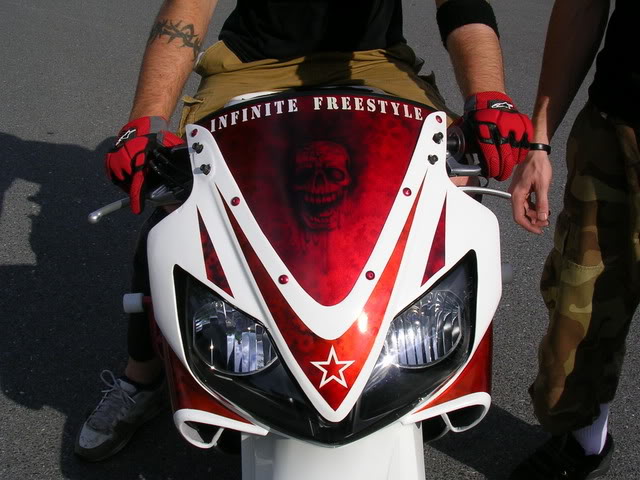

i did metalcast base coat and duplicolor metalcast blue on my rims. i recommend u follow the instructions. they came out nicely. this is them without a clear coat
