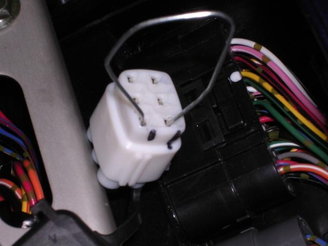

you have to put it in dealer mode
there is a little white plug in your rear tail somewhere, it does not plug into anything, do this to it using a peice of wire or a paper clip
