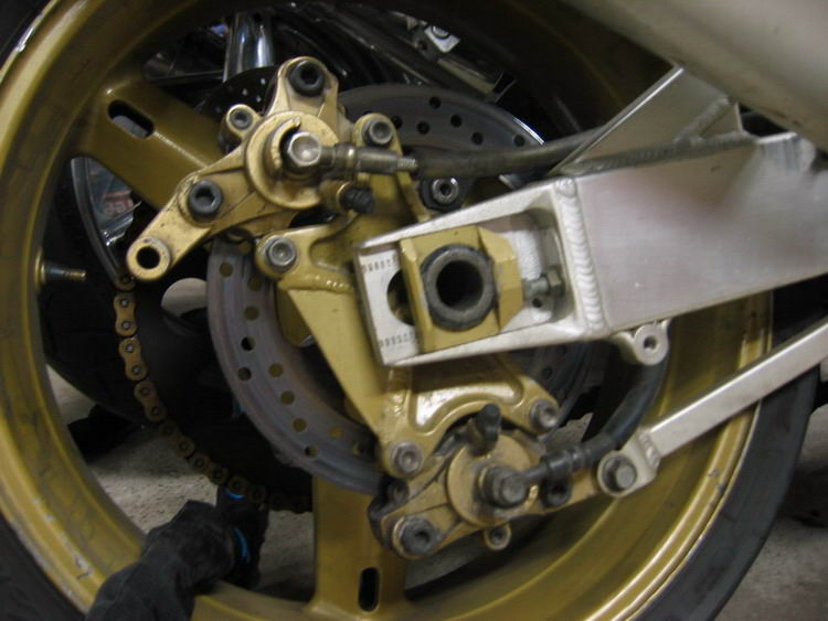

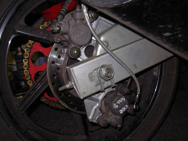

I just got a 2m long custom made while you wait stainless steel braided brake line with nylon jacket from HIS Hose for $100 (hizzle hoes lol). Service was top notch - highly recommended.
Dual caliper rear brake gonna be all hooked up this weekend. :YEAH

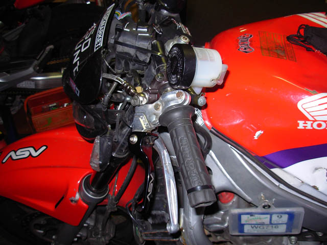

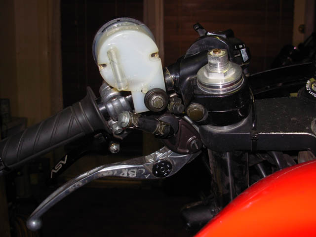

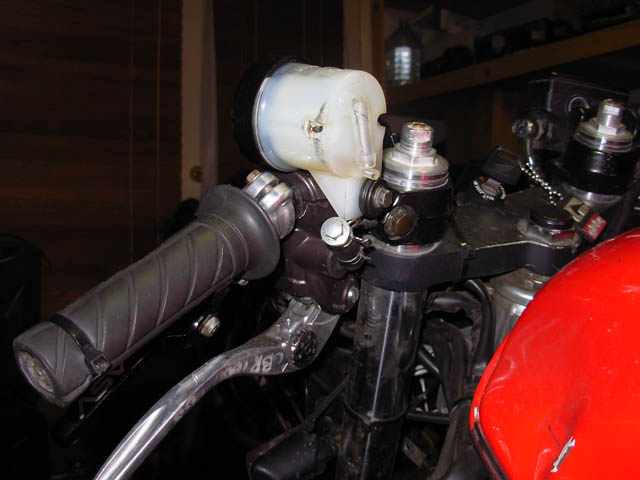

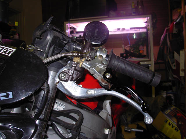

check out my rusty piece! lolol
do you think the reservoir will work ok at that angle? i expect to only be using it when i'm vertical but i'm worried it may starve/**** air due to the position of the tube out of the reservoir. i can relocate it but tell me now before i hook it up and bleed it.

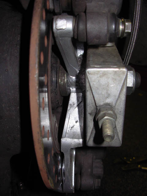

Don't think that reservoir setup will work.If you look the fluid actually goes in right at the top where I circled.
Keep an eye on your caliper mount breaking away , mine did and I ended up making a brace from one mount to the other.Will post a pic tonight.
Anyone got a pic of Mingay's setup?
Old Oct 27, 2006 | 08:00 PM
N*A*M's Avatar
Posts: 550
From: Melbourne, AUS
N*A*M is an unknown quantity at this point
Re: HIS Hose ftw!
yeah i know what youre saying about the res. i thought the same deal. only saving thing is when im in a wheelie the angle is much better to drain fluid down the hose. i might bleed it horizontal and keep it really full then figure out a better mounting angle.
so you reckon the brackets need bracing? damn gotta take it off again. i guess i should get both sides braced.

Re: HIS Hose ftw!
The other thing Nam is thats going to hurt your legs abit comming down from a highchair.
I used the rear res from a R6.Its only small and you can mount it away from the master.

I like the Dual Caliper setup, did you just get another one welded onto the bottom?
Is it any harder to change the rear wheel?

Old Oct 30, 2006 | 03:34 AM
Ned's Avatar
Ned
Posts: 987
From: Newcastle , Australia
Ned is an unknown quantity at this point
Re: HIS Hose ftw!
Sorry for the delay NAM
Old Oct 30, 2006 | 07:22 AM
N*A*M's Avatar
Posts: 550
Re: HIS Hose ftw!
cool, same as i was thinking
and i got some 8mm alu plate here just for the job
thanks ned
