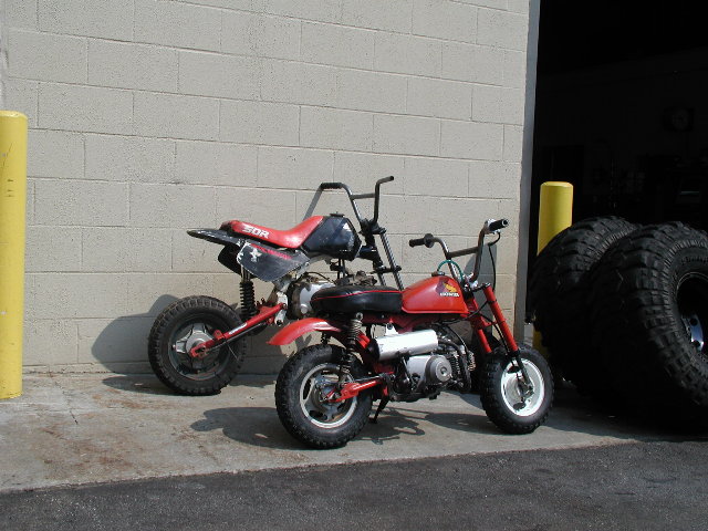

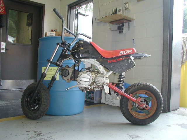

This is a junk yard special. I bought the 50 for $200 and now I have about $400 more in junkyards parts on it.
The specs:
Forks-Honda MB5 (honda 50cc streetbike)
Motor-Honda ATC110
Swingarm-Honda XR100 (4 or 5in longer than stock)
Monoshock-Suzuki RM125
Wheels- Honda CT70 (10in instead of the stock 8in)
Tires-IRC 510's (Street), still tryin to deside on which dirt tires to run

What year z50 you got there and how hard was the 110 motor to put in. The motor mounts dont line up on the top ones but the bottoms ones fits when I did a mockup on my 110. I just lost intrest at the moment but maybe your bike will motivate me again. Lets see some pics.

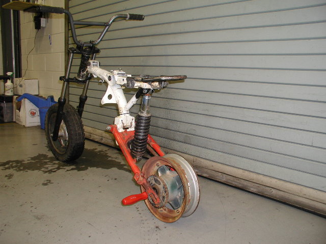

Re: MONSTER Z50 buildup
As promised here are the pics
My Z50 is a 92. The only mount I can use is the bottom mount. My friend does fab work on Jeeps and he is making new mounts

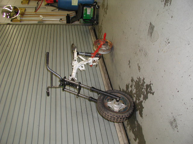

more
ID:	86534   Click image for larger version
ID:	86535   Click image for larger version

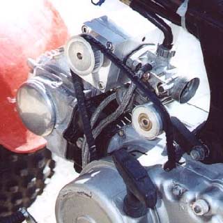

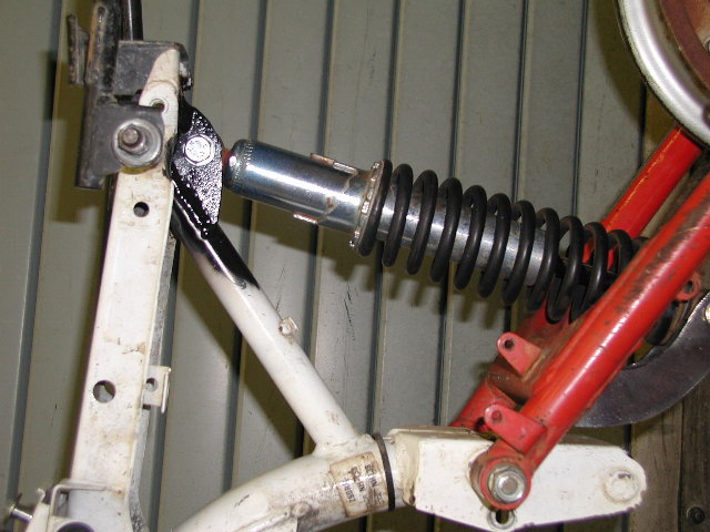

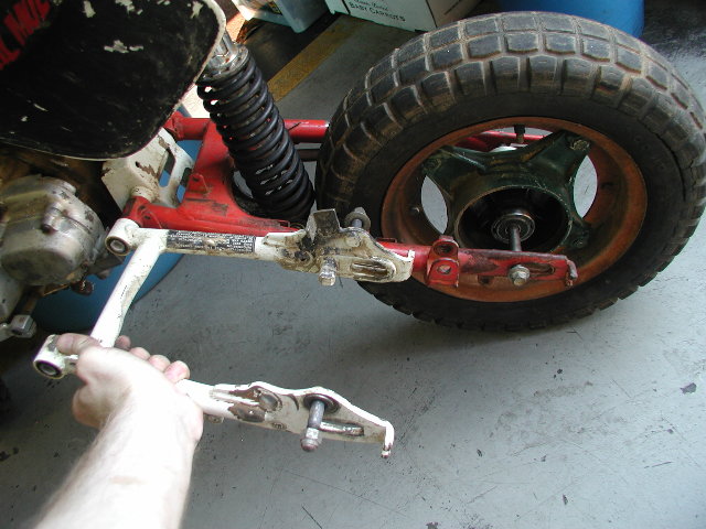

even more pics
ID:	86579   Click image for larger version
ID:	86580   Click image for larger version
ID:	86581   Click image for larger version

Doesnt the ATC110 motor bolt right on to the xr/crf/z 50?
By the way, that thing is a monster! good luck with it
That is what I was thinking too, but when I went to to mount it up the only mount that lined up was the lower mount. We are making new brackets for the upper mounts.

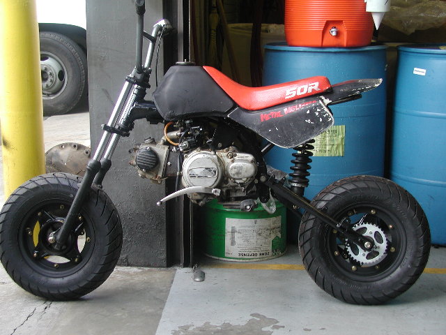

I'm almost done
ID:	94509   Click image for larger version
