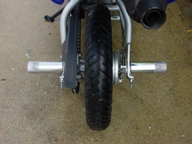

o.k guys heres the deal.I have pegs on my fiddy front and back. I took the easy way out and just bought a set of the internet. it was the easiest, with no hassles. But If you want to do them yourself heres how. there are two ways that I know of.
1. go find a set of pegs with the thiniest piece of metal where the threads are located (NO THEY WILL NOT BEND). then drill out the thread hole so it's just big enough to fit the stock axle threw. Now put a notch/line at the bottom corner of the peg.(this is gonna be your new chain adjuster guide). Then put the back tire on without the chain adjusters. Use the notch in the peg to adjust the tension. Between taking out the adjusters and finding the right pegs. This WILL work.
2. Go get a metal rod the came thickness as the original axle. The go to a machine shop and have them cut it to the exact length your looking for. then have them thread each end. then just go get some washers and nuts to fit them. Those rods usually come in like 6 ft. lengths I would have the guy make as many as he can out of it, so that way you will have extra.
Both ways you still need to just check them every so often to make sure there tight. But I haven't heard of any problems also.
I hope I explained it o.k. I f you have any questions just let me lnow..
