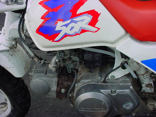

pic of the way i routed the tube, nothing fancy.
Old Jan 11, 2004 | 01:01 PM
crazeinc's Avatar
Posts: 647
From: Naperville, IL
crazeinc is an unknown quantity at this point
ok i'll try that again

No I just balled up some aluminum foil under the cap to elevate the barb to the height I wanted it and jbwelded it into place. I rode the bike for about 2 hours today and everything worked great. As far as any gains, I didn't really notice any, but I thought it was a fun project to do.
