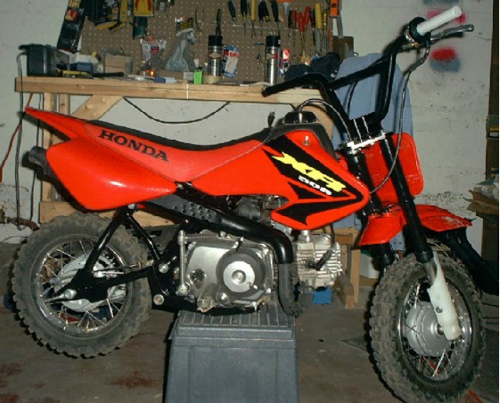

yeah that **** looks pimp. what did u do to prepare the frame?? spray right over the grease or sand it?

Process is degrease with paint thinner. Sand with 400 grit. Wipe with more paint thinner.Prime prime prime. Paint that **** then. Put it back together.
Mine is not holding up worth a damn but I didn't want to press out the swingarm bearings for powdercoat. When it rubs off I just spray it again. No big deal.

that **** looks bad ***. congrats. i esp. like that key relocation, how does it fit? would it be possible to cut a small notch for the tab and have it fit perfectly? that'd be the ****, but i wouldn't want it all loose and dangling in there. looks real nice, but mines gonna look much better , you just wait... i should have everything done in a month, stay tuned for pics.
oh yeah and what is the little black box that connects the case breather hose to the airbox? how does it work and is the box necessary or could you just run a vaccuum line to the airbox itself?
I did prep it with 400 then went down to 320. I could have done a better job..however...This was done cuz it's so damn cold out. Will it last, I don't know. Sort of really don't care. We load our fiddies piled on top of each other and that is why I have most of my damage. This would hold up a long time if it was not for loading.
However...I had a good time learning how to take it apart and put back together. What can I say...i luv motorcycles :YEAH
That is what you should do. Is to notch out a tab on the frame and it will fit like a key Did I do that ? NO...why...i really dont care...I just notched out the ignition and put it in there. will it fall out...nope.
B
That box is no longer on there. My buddie removed his and claims he picked up more wheelie power? I have no clue...but with after market filter that box gets eliminated anyhow....

Originally posted by yzfrone
yo how long did all that work take?
It was a 2 day process with 10 man hours total.
