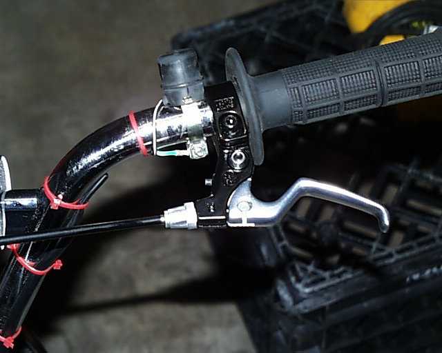

1. pretty self explanatory, its the bmx lever on the handlebar

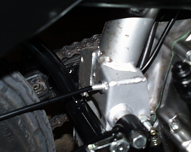

2. Now route the cable through the hole in the frame, this is the trickiest part, my suggestion is to run the cable through the adjuster nut, then run the bare cable through the hole..
Old Jan 6, 2004 | 08:29 PM
02redr1's Avatar
Posts: 1,359
From: OKC, OK
also, run the nut part on the backside to secure the adjuster

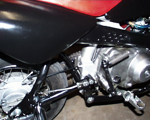

next, drill a hole to fit on the rod that runs through the swingarm and a small hole that the cable will fit through, then double nut on both sides, you will also need a spring (smaller than original to run from the plate to the rear brake link adjuster thingy....also, the part of the cable that you cut off to fit (casing) put that back over the cable itself and it will serve as somewhat of a rub protector just incase your tire happens to ever touch it...

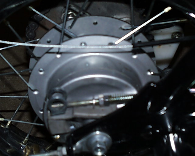

here's one last pic in the middle of assembly, but you're done....
the whole project cost about $19, but if you can get the parts cheaper you may be able to get it down some...

been running something like that for the last few weeks, but I just wrapped the cable around the nut on the rear brake and put a pinch bolt/nut on the cable to hold it there. Works great, I can even lock up the rear with the handbrake
