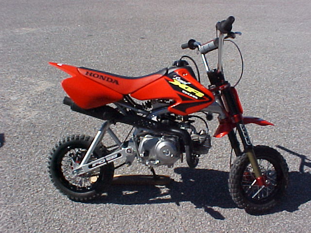

my friend has that and that sucker grabs
Damm that thing looks like it sits high as FU(K.
anyhow. do you know if it is possible to hook both the rear and the front brake lever up to that thing?

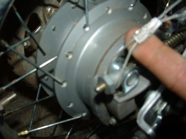

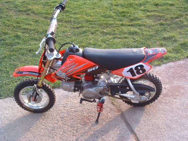

I made one heres what you need
1 perch and lever - i used one off a quad
1 brake cable - you can get at any BMX shop i used oddesy
1 metal hose clamp - get at a hardware store
2 cable crimps - hardware store
then just rig it up. the hose clamp, goes on the swing arm no where else, i found out that if you put it anywhere else, when you sit down and compress your shock it will cause slack in the cable

once you run the cable along the frame use plastic zip tie to hold it to the frame more towards the center where theres a gap in the plastics on the side. you may need to strip some of the plastic off the end of the brake cable to get some more of the metal cable to show. loop it around and then clmap it. it took me a lil to get it right but you will get it make sure you clamp the hose clamp down of you won't be able to see if its working or not.

make adj on the length of the cable then make a loop with the cable clamps, loop it around the adjustment nut in the back and then mess around with it

done

its nothing like the foot but its enuff to slow ya down in turn or bring ya down from a wheelie so ya don't loop. it gets a little tricky putting it all together but its worth it in my opinion. thanks for the kind words guys
