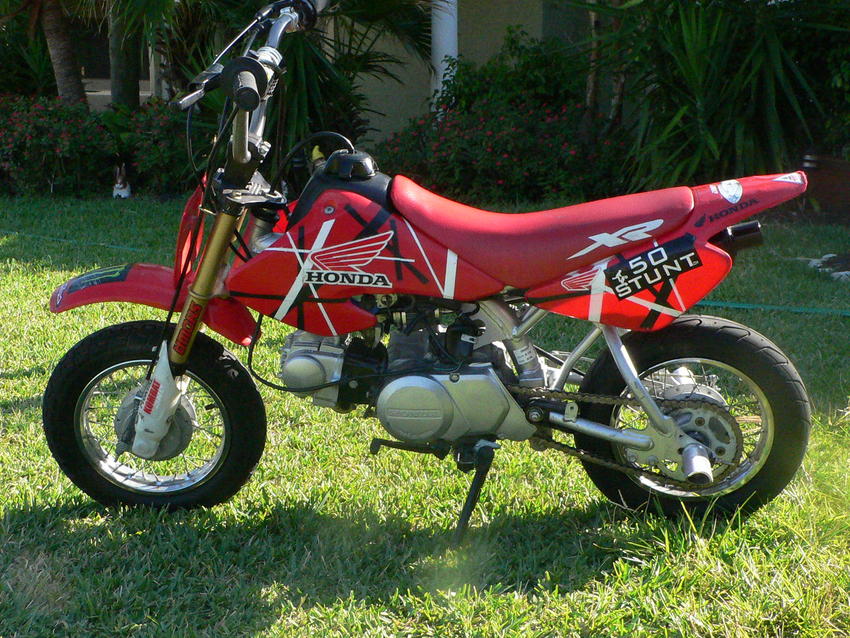

I'm not sure what was done to my 01' XR50 before I bought it ,but it has major nuts!! It will easily flip switching from first to second gear if your not careful.And it's almost impossible to keep the front wheel on the ground!!!! I love it!
