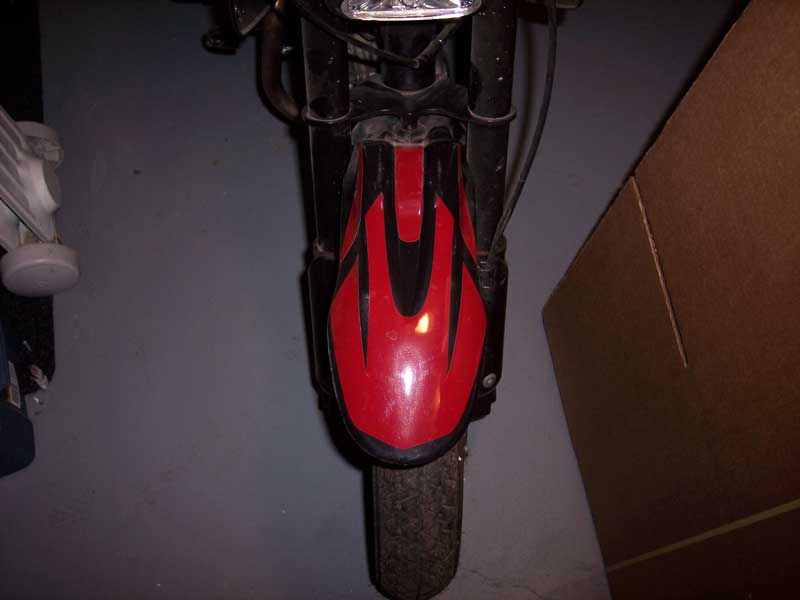

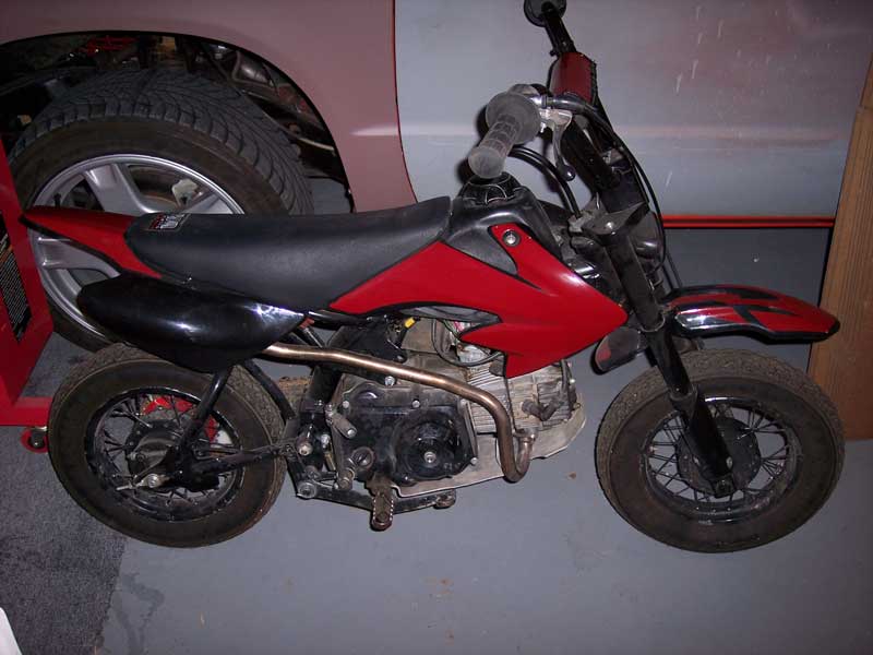

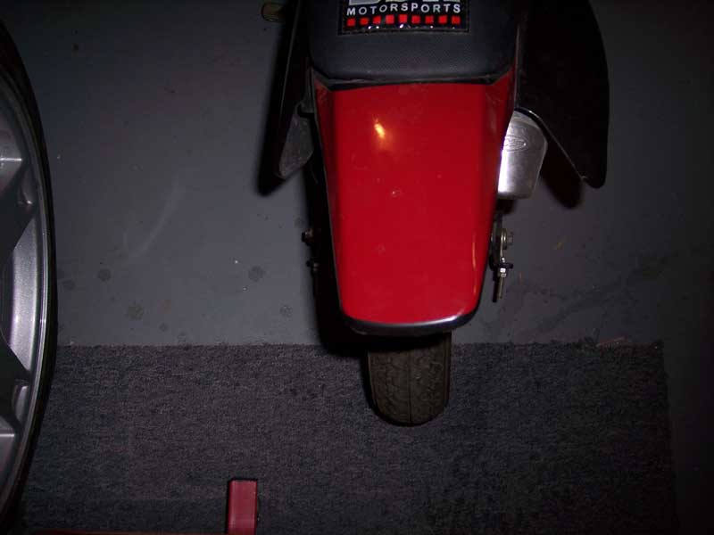

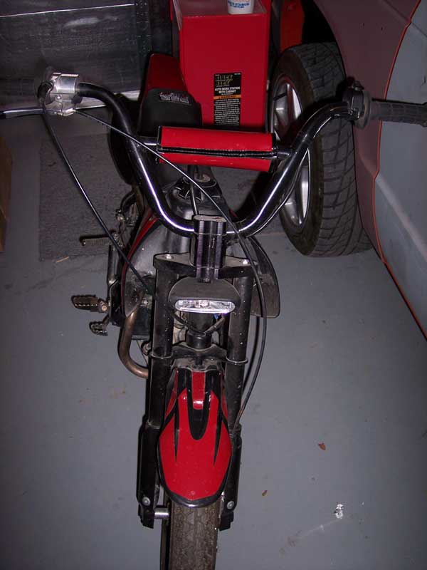

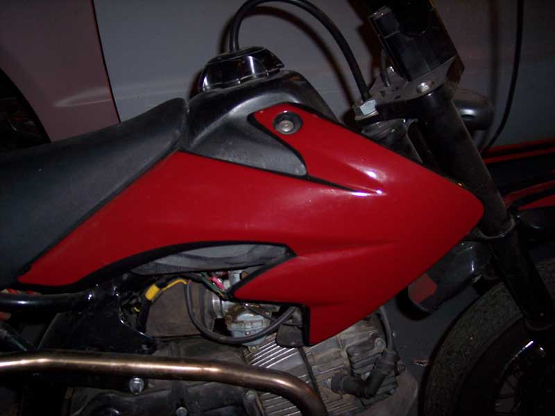

I had my friend cut the vinyl for me to fit most of the plastics on my fiddy, and then with the excess vinyl I cut my own design for the front fender ...
I just used water in a spray bottle and a vinyl squeegee... i turned the vinyl sticky side up sprayed it with water till it was soaked... fitted it to the plastics and then used the squeegee to work out all the air pockets... it will dry and stick as you are working on it...
it took me a while to do it, and my fingers were very sore... but i did it and it looks great!!! We just brought the bike home so we can change out the forks, but I will go snap a pic of the plastics and post them ...

those are not done yet ... i still will be putting on black glitter flames with my text to say "Fiddy Brat"
