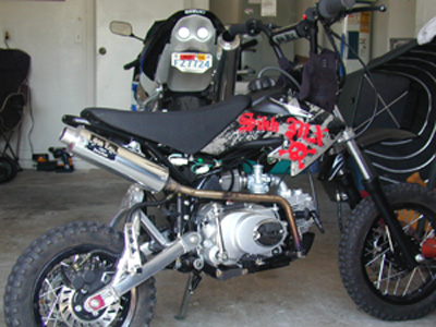

Here it is.........
Name:	107 Sikk MX.jpg
