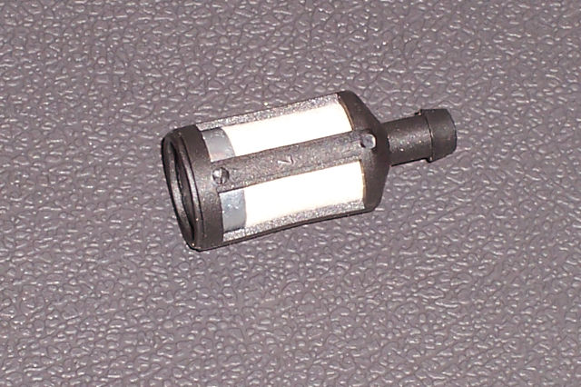

In the first pic you can see the "breather" filter I used. It's actually an in-tank fuel filter for small engines found on some lawn mowers. It measures 3/4in in diameter and 1 5/8in long with a 1/4 in barbed end.

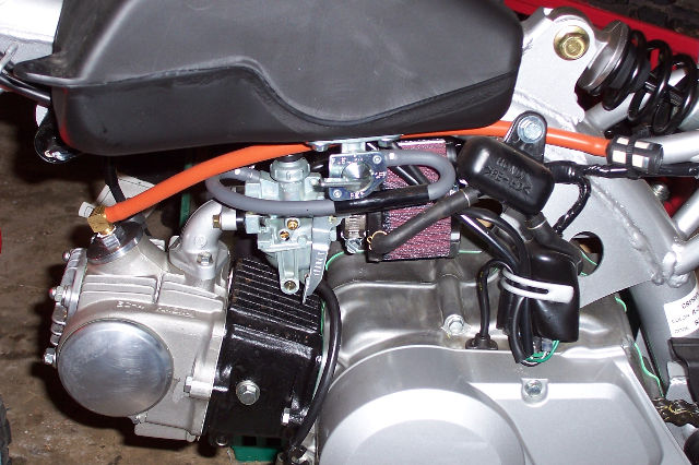

The second pic shows a brass 90 degree fitting (1/8 NPT x 1/4 barbed end) screwed into the top of the intake valve cover pointing rearward. I did this by unscrewing the valve cover, flip it upside down with a rag wrapped around the egde and lightly clamp into a bench vise. Find the exact center of the valve cover using an 11/32in drill bit, and drill all the way through using light pressure. The cover is aluminum so let the drill bit do the work. I then tapped out the hole to make threads for the brass fitting with an 1/8in NPT tap. Clean off all the metal shavings, torque the valve cover back onto the head and using a little bit of teflon pipe sealant, screw in the brass fitting until it's snug and pointing in the direction you want.
The third pic I used a length of 1/4in I.D. silicone hose (holds up to oil and heat well) that I had laying around and ran it under the tank near the rear shock and secured it up with a zip tie to the frame.
The fourth pic is the final product after all is said and done. Very inexpensive and it adds peace of mind knowing the hose won't pop out of the valve cover and trash can't enter the engine through the breather.
I found all the parts at my local NAPA store and cost me about $3.00 total.
Filter # 7-02366 (about $2.50)
Brass fitting # 05704B-C02 (about $0.50)
This may run a few more if you dont have the tools required. Hope this can help.
