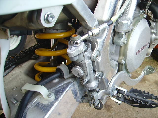

r1 master, i think i need a better master. it works ok but i need to pull hard. 50" brake line. the line was a little long but thats ok. 3/4 inch aluminum. i think 1/2 will be fine. and i had the fluid hole viewer welded shut cause it couldnt hold the pressure and popped off. tools i used was a grinder, drill press, and of course the tap. hope this helps

yeah that looks complecated and home made (no offense) when i get my honda set up im going older yz250f rear master and the full throttle adapter, ill prolly take mine right off my current bike and just get a used one to go back on the old motard

looks good enough for me, if i ever find time then ill probably just make something work.... hows the rear brake working with the motard wheels on it? Maybe im just in need of bleeding it some more

yup its definatly home made. cant expect to much from a grinder and a drill. i tink the master sucks or somthing its got rash on it and came off a crashed bike so that may be why. it works fine for doing seat standers in first gaer. i havent tried it going any faster but im sure it will work fine.
