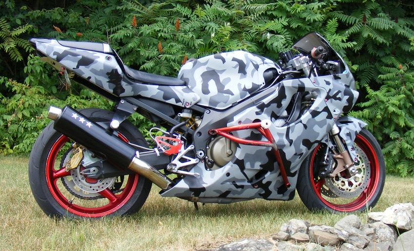

Old 03-18-2010, 01:48 PM
havok's Avatar
Join Date: Jul 2006
Location: kingston NEW YORK
Age: 43
Posts: 3,730
Re: 929 fork problem on my f4i!!!!
heres mine...if that helps ya beardo.
