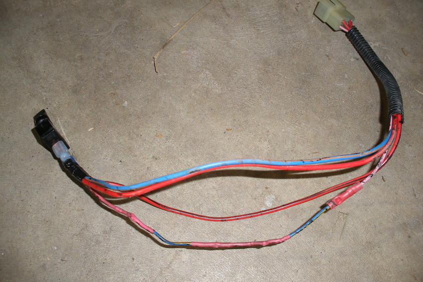

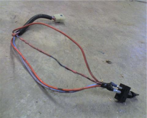

Originally Posted by nickstanislaus
Thanks I guess i did see that but i was looking for pics? I tried the same thing kinda on my 600rr and the diode got extremely hot. I guess we will see if anyone reports any issues.
here's a few for ya
ID:	237381   Click image for larger version

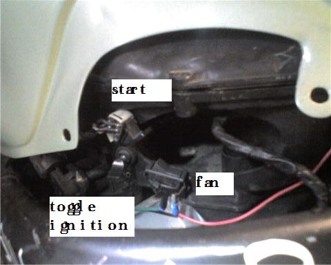

here is mine
Name:	ignition - Copy.jpg

5.1 zener diode and 1 khom resistor on the pink wire
I put this stuff on pink wire that go into "HISS" right???, but can i remove it than or do I leave the way it is and just hide it somewhere into frame or airbox??
Old Mar 15, 2010 | 05:15 PM
Jerro's Avatar
Sugar Free
Joined: Aug 2008
Posts: 252
From: b-town, arkansas
Jerro is a decent person
Re: F4i keyless ignition?
if you're makin it a toggle you cut all the wire and remove the key
Leave the red/black on one side and connect the other three (red, blue/pink, and pink) to the other side.
Pink wire - Get a 5.1 volt zener diode, the black side goes towards the pink wire, soldered it along with a 1 kohm resistor
