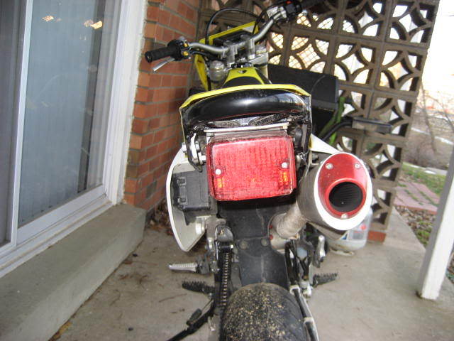

I have a baja designs rear brake light/ plate mount.
It comes off with 2 bolts and the wiring goes through 2 4 flat trailer connectors so it just unplugs.
For the cheater peg, you can build a flat plate that is bent 90 degrees that bolts on top of the fender to rest your foot on or bolt a BMX peg to the subframe somewhere around where the side panels meet the rear fenderin the back. You might not have subframe there being a true motocross style subframe.

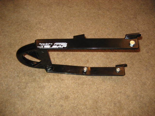

axel pegs are used for crash protection, stuff puttin ya foot down there
make a bar like this one with a peg mounted off the left side, it will be easy to take off when not needed
or make a new sub frame like this, no good for off road
I agree the other custom subframe option is not a great option for me since primarily its gunna still be used offroad, just local lot stunting when I get bored after work, heh.

On a side note, your 12 bar I don't see that listed on powers stuntworx site. I emailed them though, did they make it custom for you?
I have a 450X though, not a 450R. I'm HOPING the frame is the same so I can hook it up too

all those pegs are bmx pegs they al look different lengths did you cut them down for the fork and swingarm sliders
Old Mar 25, 2009 | 10:11 PM
mxsam34's Avatar
Joined: Nov 2007
Posts: 104
mxsam34 is a decent person
Re: CRF450 Stunt pegs & wheelie bar
yep, there too long standard, they would dig in whe leaning over if i did not cut them

sorry to bring an old thread of mine back to life, but I contacted Powers stuntworx regarding the 12bar for the CRF, and they knew nothing of it.
They said they would require my subframe off my bike so they could attempt to make one. I'm located in Canada so that probably wont work for me, so out of curiousity how did you land yours in the previous postings?
