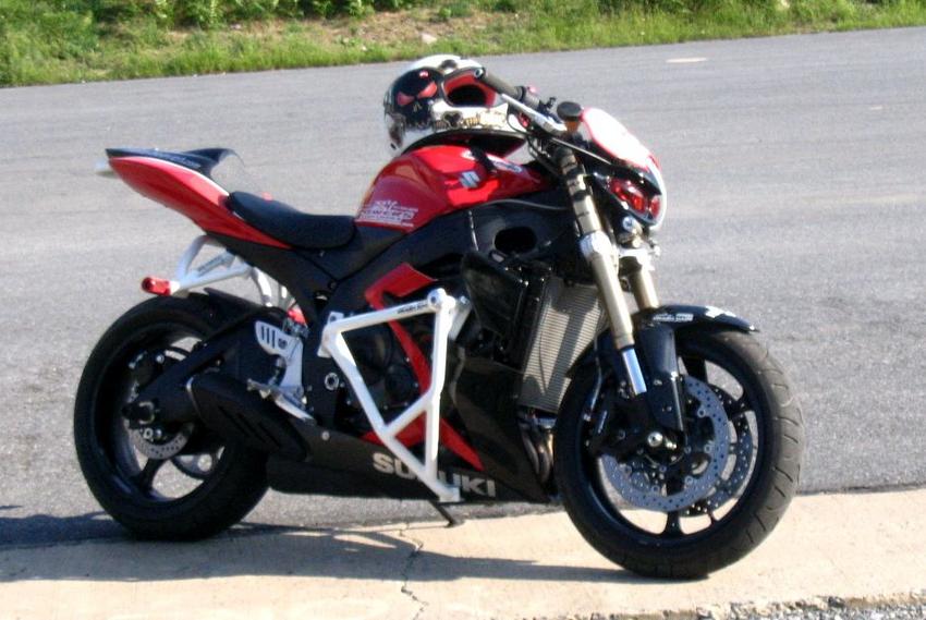

u just have to take ur time,,,,be very precise...it can work fine..heres a pic of my old gsxr with dirtbars...eventually went to clipons...but i miss that feeling of dirtbars on that bike

what kind of risers did you use? and did it require spacers on the bottom

They were tag 7/8" bar risers. Believe I used aluminum spacers from a powers cage. The spacer fit snug over the bolt and was about 1/2" long. Then a washer ontop of that and the nut. I only used spacers so I could make sure to tighten the nut bevy there isn't that much space under the tripple bevy of the way it's casted. If u drill the holes in the riteplace, the spacers sit flat on thetripple
