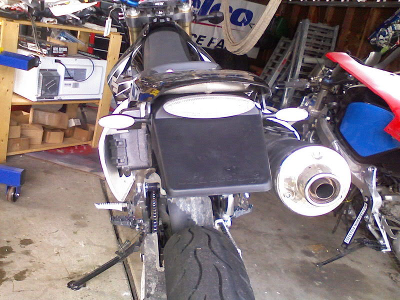

I have a baja designs rear brake light/ plate mount.
It comes off with 2 bolts and the wiring goes through 2 4 flat trailer connectors so it just unplugs.
For the cheater peg, you can build a flat plate that is bent 90 degrees that bolts on top of the fender to rest your foot on or bolt a BMX peg to the subframe somewhere around where the side panels meet the rear fenderin the back. You might not have subframe there being a true motocross style subframe.

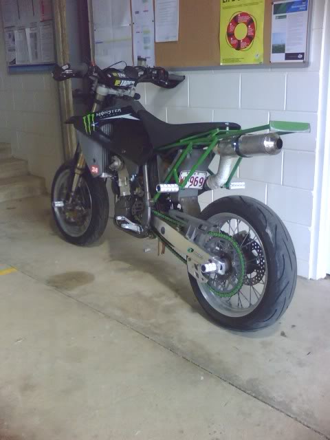

make a bar like this one with a peg mounted off the left side, it will be easy to take off when not needed
or make a new sub frame like this, no good for off road

Hey amp3d if you have a look around the motard forum topics i posted up some pics a few days ago of how i mounted a staggered peg on my CRF it worked out sweet

here ya go mate! cant remember where i posted them before haha
el sammo is offline   Reply With Quote

Looks awesome, and simple enough! I think we have a winner!
On a side note, your 12 bar I don't see that listed on powers stuntworx site. I emailed them though, did they make it custom for you?
I have a 450X though, not a 450R. I'm HOPING the frame is the same so I can hook it up too
