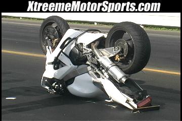

parked. THey have this shot in the new Super Streetbike mag.

everything was full of oil on his. did this for about 2 hours

yeah ... the bike wouldnt start, so I trailered it home .... any ideas on what to do to get it running? should I drain all the fluids or what? it was upside down for a few minutes

How long was the bike runing upside down? Did it shut right off when it flipped or did it continue to run?

it shut off immediately, but I let it sit there for a like 3 minutes ....

You need to pull the gas tank. You need to pull off your air box and look at /clean the crap out of it. Take off your velosity stacks. Clean them. Crack your throttle wide open and see if oil is in that cavity(injectors/floats). If there is you need to get it out of there. See if the engine will turn over at all. If it will you are stoked. If it wont get some cans of compressed air, pull out your spark plugs. Clean your plugs and go nuts with the compressed air or an air hose in the spark plug holes and down into the floats in your injection. Your really just trying to dry out everything. If that won't work you probably have pumped oil from your engine and locked your floats up while the bike was running upside down. Again just clean and dry everything and it will work. Just remember it ran before you flipped it. Good luck.
