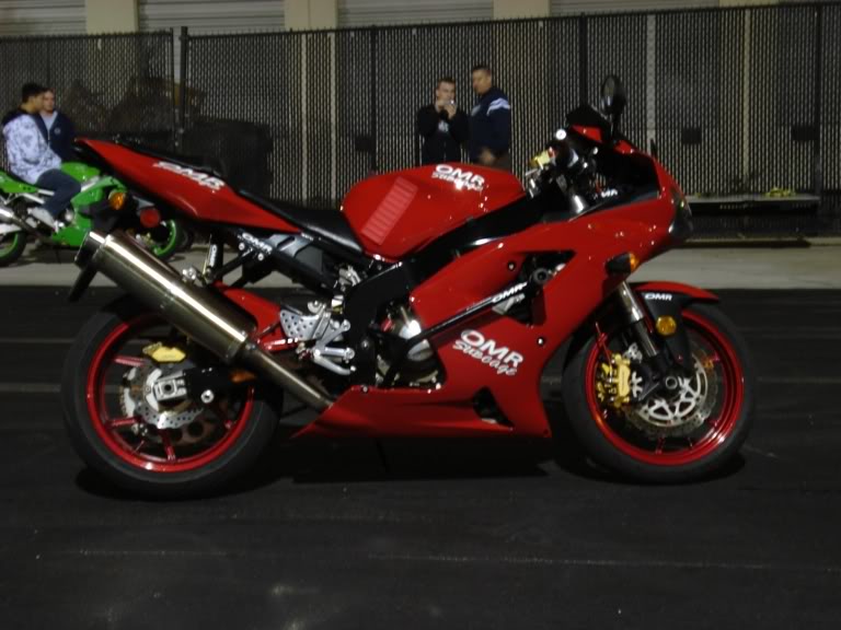

well i don't have any good pics and i ride a 636 so i don't know if it will help much but heres a pic from the side , you can see how much higher they are

Nice bike bro!! The clip ons look a little like they're angled up..? Maybe jus the way the bike is sitting in the pic. Are they actually straight across? And Whats with flipping them?? Can you elaborate??
Sorry for all the questions, I'm the only guy around here that rides.. Don't have anyone to help.. So basically I read on here and go try a few things and read some more... Thanks for all the help!!!

Roger,do you make this cage for your bike? why you didn't make a full cage?

on the 636 you can flip the clipons over and you can put the right clipon on the left side and visa versa it raises them up higher and they are a 7 degree clip on so they do angle up a little ...i don't think that works on the 600rr because of the style of the stock clipons

yep thats an omr original...lol it is a full cage but i didn't want it to go under the bike so i mounted it to the swing arm bolt and the motor mount
