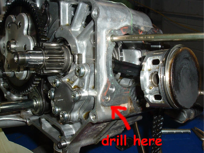

I just did the High Volume Oil pump, and i didnt drill out the hole as straight as possable, i think i kinda angled it abit. I know i didnt drill into the case tho. Am i going to expierence any problems now? Thanks, and wish me luck

I drilled mine the same way, because I couldn't get the drill lined up perfect with the stud there. I've had no problems! :YEAH

you souldn't have any problems w/ yours, but the correct way to do it is to take the one open ended 10mm nut and a closed ended 10mm nut, put them on the long stud (the one that's in the way), lock them together, then use the open ended nut to unscrew the stud, then drill and reinstall. here's a pic from when i did mine (http://www.stuntlife.com/forums/atta...chmentid=61229), you can see the threads where the stud screws into the block.

What size drill bit do you use?

2mm......................
