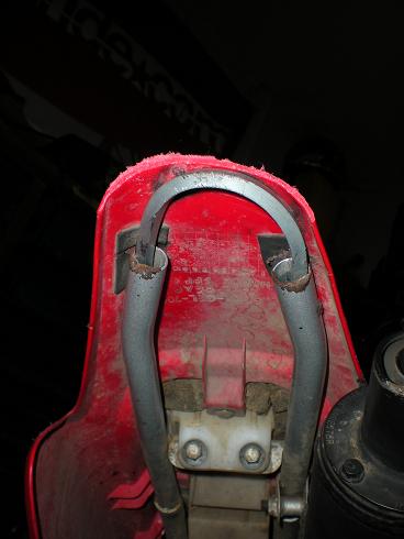

heres a pic of mine, its only purpose was to support the rear fender when I step on it. just bent a piece of steel and hammered it in

If that is the case, you can use 1/2 or 3/8 cold rolled steel. Beat it down into the tubes and tack weld it, and you should be good. An ole buddy of mine, LTW cut his sub frame off and welded a new one on, and it worked perfect, but it helps if you weld, or know someone who does... I have built 12bars, roller bars, and hoops. Trust me, hoops are the way to go...
